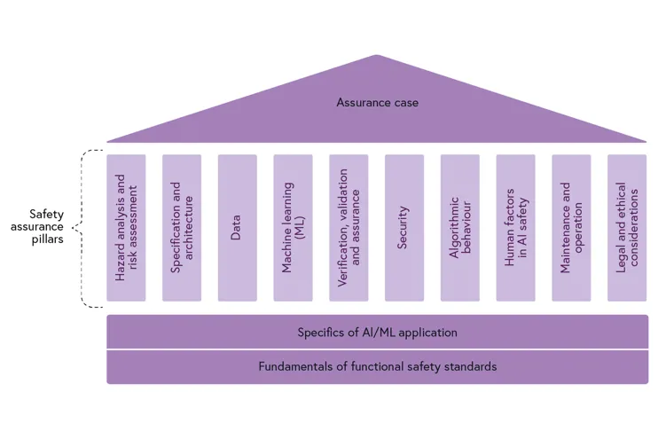

Aimed at non-specialist senior management, this is a high-level work designed to provide information that is vital to decision making. At its heart are 10 key ‘pillars of assurance’ that need to be considered when assessing the risks of using automated systems in safety-related environments. With the objective of ensuring the safety and wellbeing of individuals, as well as protecting assets and the environment, it outlines additional considerations required in engineering processes and provides advice on building assurance cases.
Ten ‘key pillars’ highlight points that should be considered when implementing AI elements within safety-related systems.
