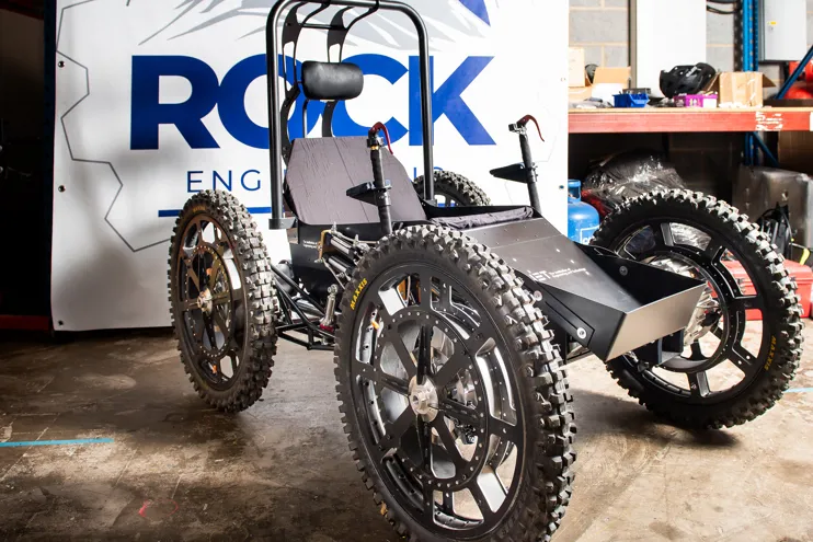

Ninety per cent of the design is completely unique, based off our combined decades of motorsport and off-road experience. There are other off-road wheelchairs out there, and they are all very good in their own way, but we like to say that comparing RockClimber™ to other off-road power chairs is like comparing a mountaineer with a trail runner – they are two very different things. For it to be able to carry 300kg up 1,000 metres over a distance of 10km unaided, we had to consider both high-level and macro problems of terrain and obstacles. In our latest attempt in July, it did just that and we managed to scale over 90% of the mountain – 1,020 of the 1,085 metres – with Nick in the chair, completely unaided.
Key features of RockClimber™ include:
  • Stability: The centre of mass is kept low and positioned to maintain tyre load. The wheelbase can extend 400mm rearward for extremely steep terrain, maintaining stability at climb angles greater than 60 degrees (in theory!)
  • Traction: The vehicle has an electric four-wheel drive system to maximise traction. The system can bias torque as the climb angle increases. Reducing sprung mass and increasing un-sprung mass, coupled with a custom high articulation suspension, maintains higher tyre loads for improved traction.
  • Torque: One of its biggest strengths is its 1,600Nm of torque. Its custom 100:1 reduction gearbox allows for extremely high levels of torque from low-power, high-efficiency electric motors. It can achieve 6km/h, whether on the flat or climbing, on a 40-degree slope. In that situation, our biggest challenge would be the safety team trying to keep up with Nick!
What were the biggest challenges faced during the design and development phase?
The main challenge was developing a unique steering system that would be unaffected by obstacles during the climb. Our solution was a bespoke, in-house-designed passive hydraulic system. Unfortunately, the steep terrain encountered during the climb was challenging to simulate fully and the steering failed on our first attempt.
Despite this, other components performed well, so ahead of our second run we went back to the workshop and re-engineered solutions for the steering, tyres and brakes.
