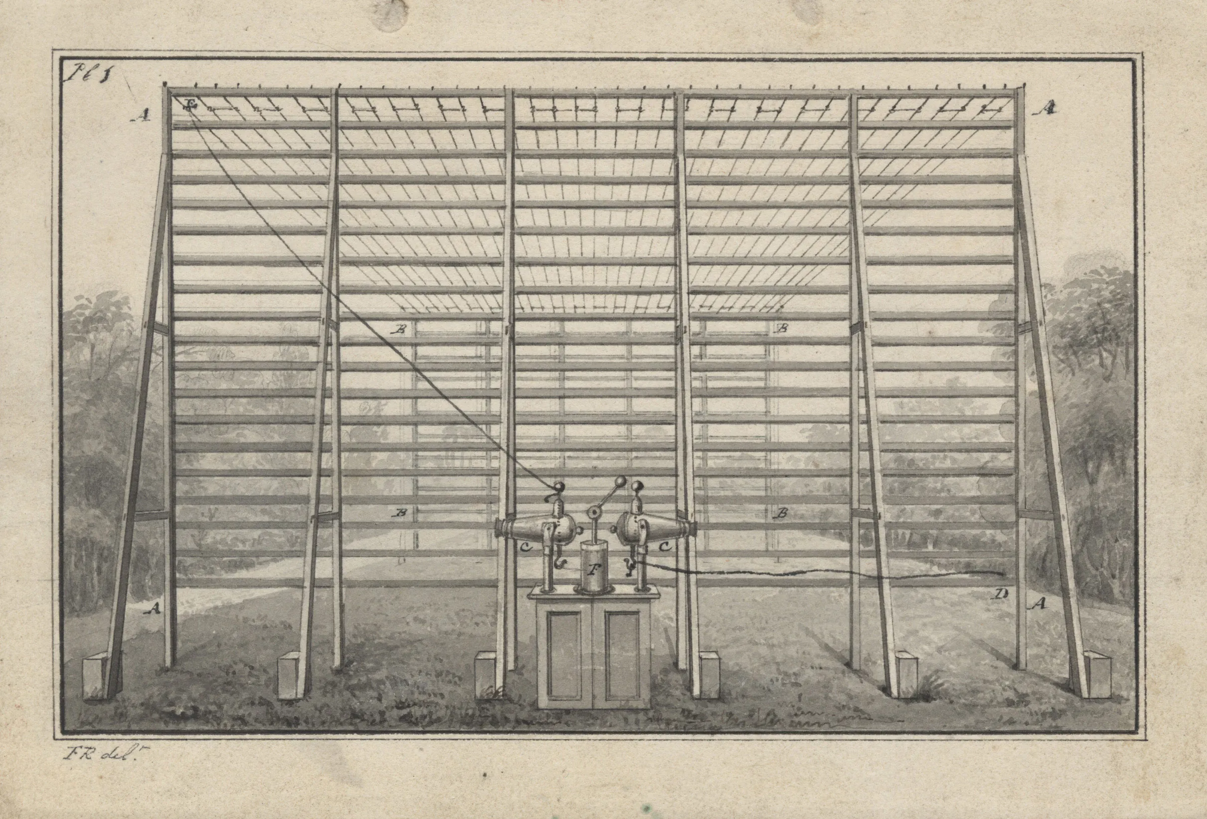

In 1816 Francis Ronalds, then living at Upper Mall, Hammersmith, built in his back garden two frames to accommodate eight miles of wire for his new invention of an electrostatic telegraph based on synchronously revolving discs.

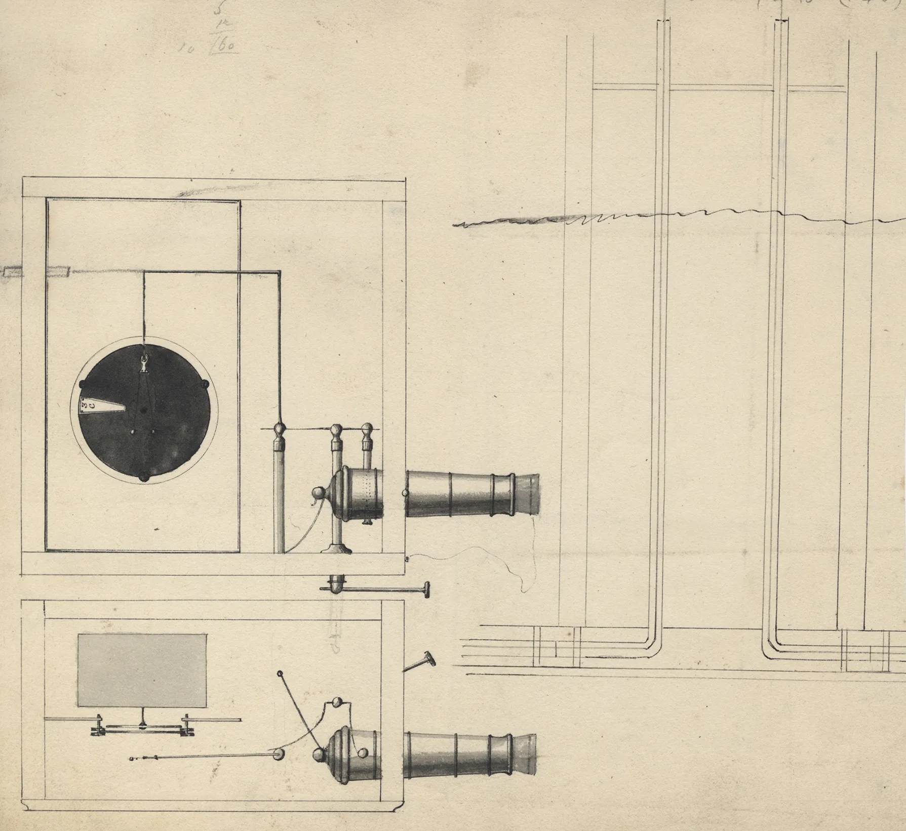

After sending messages along his wires on the frame, he developed another version in which the wires were enclosed in glass tubes buried in the ground. At each end of the line, a clockwork mechanism turned synchronously revolving discs with letters on them. A frictional electricity machine kept the wire continuously charged, while at each end two pith balls hung from the wire on silk threads, and since they were similarly charged from the wire they stayed apart.
When someone desired to send a message he earthed the wire at his end at the moment when the dial indicated the desired letter. At the receiving end, the pith balls would fall together when earthed and the recipient noted the letter showing on his dial at that moment.  The system was slow and depended on the two dials staying in step, but Ronalds demonstrated that it would work over 150 metres of wire.
