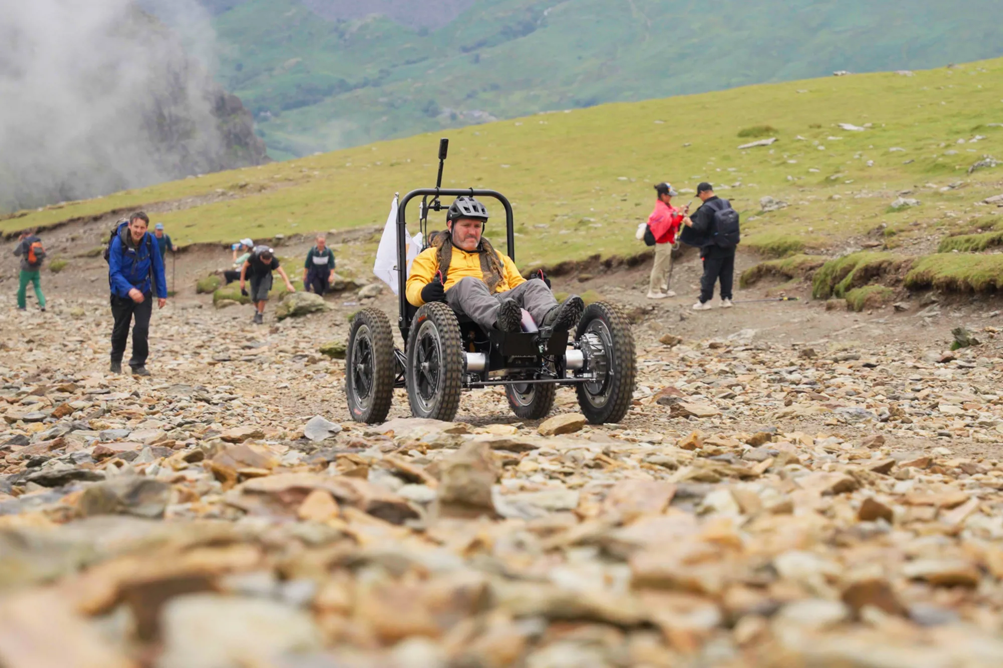

As part of Disability Pride Month, mental health campaigner and disabled adventurer Nick Wilson has reached the highest point accessible on Yr Wyddfa (Mount Snowdon) ‘unaided’ using a first-of-its-kind engineered all-terrain mobility chair, RockClimber™.
Following a first attempt in June, Nick took to the Llanberis route once more to reach the Bwlch Glas, a staggering 1000m up, without any physical support.
Nick’s climb aims to raise greater awareness and action towards current accessibility and independence challenges faced by wheelchair users every day, importantly showing how inclusive design and engineering can help to make the world more accessible for everyone, everywhere and positively impact lives.
RockClimber™ is based off extensive motorsport design experience to create a new chair concept. It includes 4x electric motors enabling 15Hp of power; bonded aluminium construction for maximum strength and minimum weight (210kg); 4-wheel drive with variable wheelbase to help with climbing and a range of 50 miles on flat terrain.
After the steering failure during the previous attempt, the team reviewed the collected data and agreed a series of enhancements that would ensure RockClimber wouldn't be the point of failure again – this included new steering, brakes, wheels and tyres.

Rock Engineering Director and IET member, Elliot Dason-Barber, added: "We are all incredibly proud of what we have achieved with RockClimber. Our goal was always to design, and manufacture, a power-chair that would give Nick the capability to scale Snowdon truly unaided, and I think we've shown we've done that.
“It has been a real privilege to help Nick achieve his goal, but Rock Engineering has also had the opportunity to develop its own experience in inclusive engineering and demonstrate its capabilities in vehicle design. This project has given us a real opportunity for accelerated learning, and several attempts on Mount Snowdon have meant that RockClimber is now a very mature, and well understood design. It also means the team have lots of ideas for how to make things even better.”
