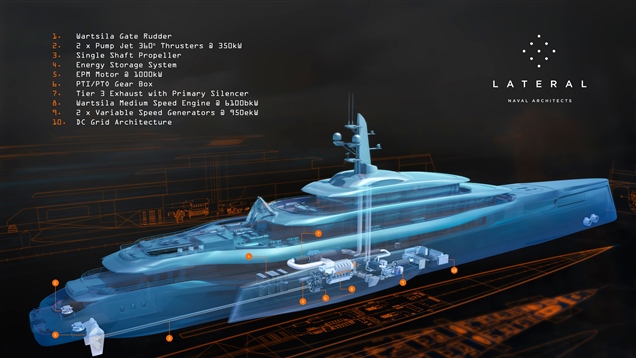

At a generous cruise speed of 18 knots, the trimaran's propulsion power needs are 20% lower than the baseline 110m monohull: placing Spear’s power demand equivalent to an 80m monohull with twice the usable GT. Leveraging the larger dimensions, Spear offers a medium-speed engine at the core of the energy architecture, often found in large commercial vessels, providing a further 15% fuel saving per kW compared to a typical yacht’s high-speed engine.
Sized for an efficient top speed of 21 knots, Spear’s engine then has efficient excess capacity at reduced speeds. Integrating a power-take-off (PTO) / power-take-in (PTI) capable gearbox into the system allows us to harness this excess capacity to power all the domestic loads of the yacht when cruising. Coupled with an electrical DC Grid for load balancing, we arrive at an efficient, flexible system architecture.
