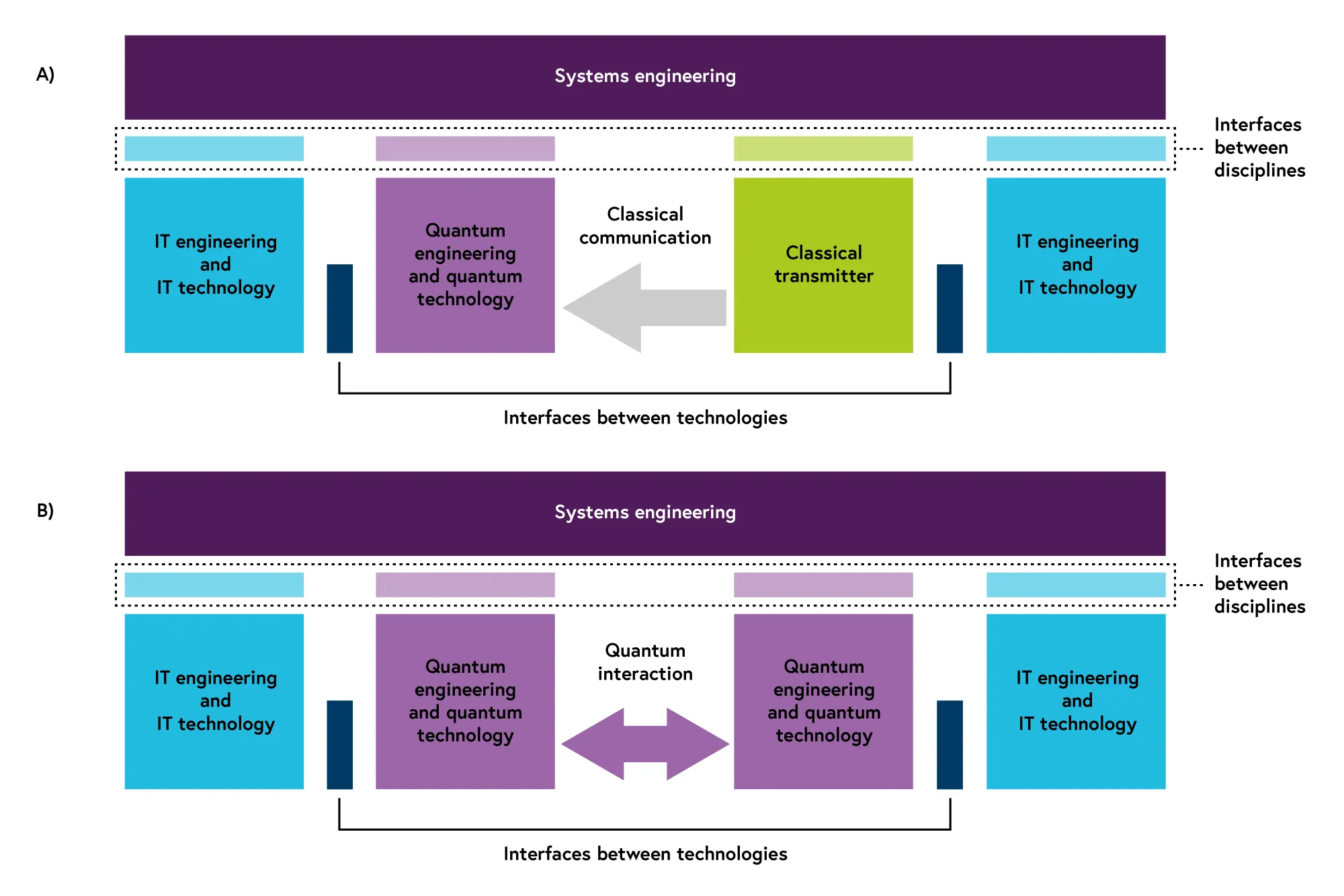

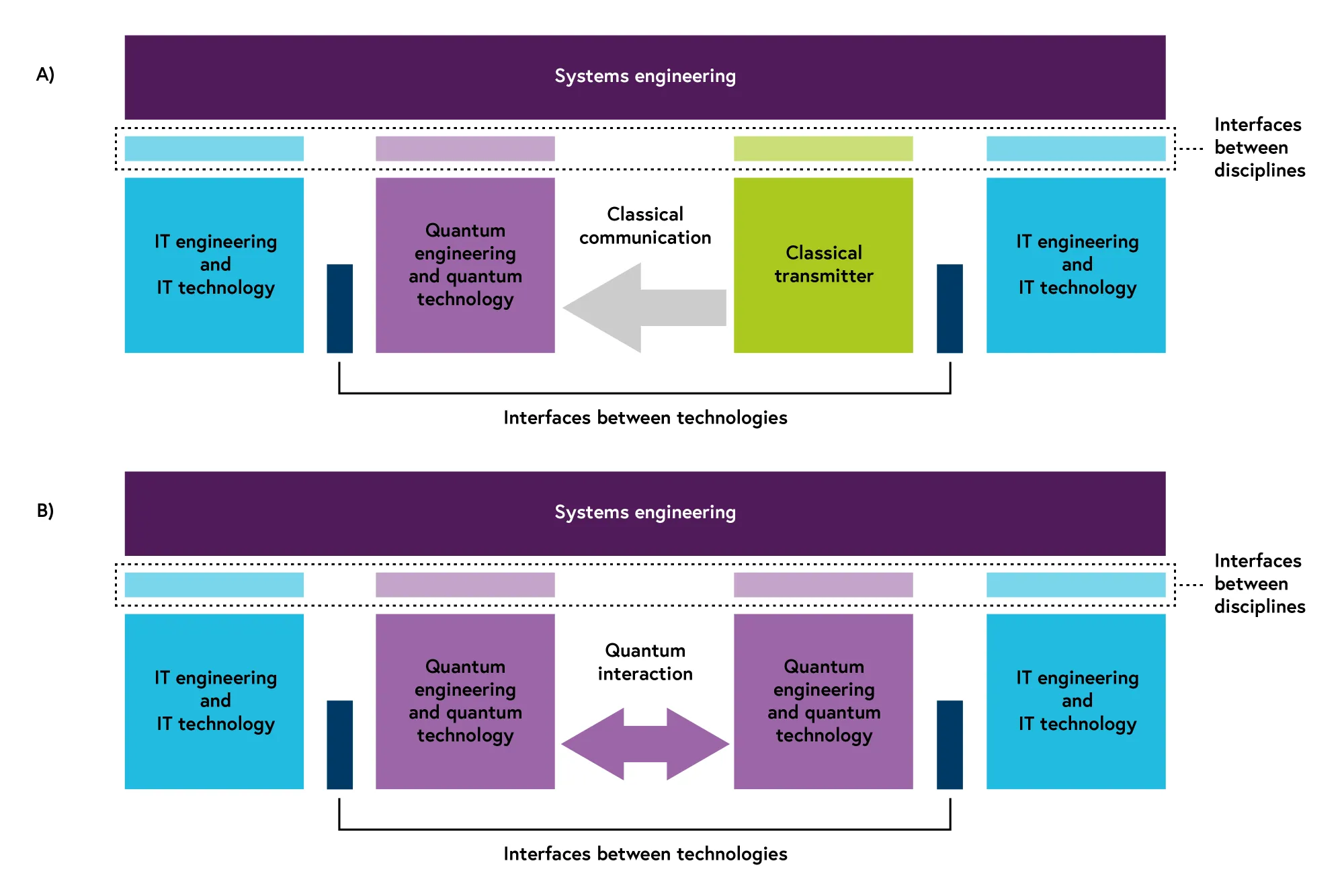

The containment of quantum effects: maximising the use of conventional systems engineering methodology
If conventional systems engineering methodologies are to be retained, then approaches and mechanisms for incorporating quantum technologies need to be devised and codified.
Systems engineering of quantum-based systems may need to be developed as a specific discipline in its own right; this would allow quantum technologies to be integrated into wider systems while allowing conventional systems engineering to be retained as far as possible.
The challenges are, therefore, twofold: (i) how to successfully engineer the quantum aspects of the systems and (ii) how to interface these with the remainder of the system consisting of more conventional technology substrates such as IT.
This principle is shown conceptually in Figure 3 for quantum-enhanced and quantum-enabled communication systems
Examples of how interfacing could be handled in a communication system containing quantum technologies to integrate with conventional systems engineering. Indicated are places where interfacing between technologies and disciplines is required. The interfacing between quantum and other quantum or classical systems currently require development. (A) The interfaces for a quantum enhanced communications system, using a quantum receiver (B) The interfaces for a quantum enabled communications system.
