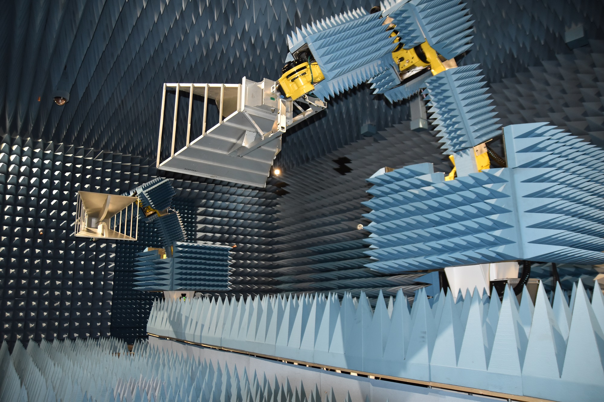

This course focuses on the practicalities of antenna measurements, asking what do we want to measure and how do we do it. Covering the theory, techniques and best practices used to acquire and interpret high-quality measurement data.
Led by Prof. Stuart Gregson, alongside Dennis Lewis and Dr.-Ing. Marc Dirix, this course draws on the expertise of internationally recognised antenna measurement specialists. Stuart is the lead author of Principles of Planar Near-Field Antenna Measurements and co-author of Theory and Practice of Modern Antenna Range Measurements. Stuart and Marc are also co-authors of the recently published Algorithms and Numerical Techniques for Modern Antenna Measurements in MATLAB®.
Topics covered include an introduction to antennas and antenna measurements, planar, cylindrical, and spherical near-field measurements and theory, compact antenna test ranges, advanced antenna measurements, uncertainty budgets, post-processing, reflection suppression, compressive sensing, antenna measurement applications, MATLAB processing and much more!
Key learning objectives
  • Learn the fundamentals as well as advanced Antenna Measurement techniques
  • Gain an understanding of planar, cylindrical, and spherical near-field theory from a measurement perspective
  • Learn the theory and practice of Advanced antenna measurements, range assessments and error budgets
  • Understand the practicalities of taking high quality measurements including selecting measurement type and measurement setup, choosing near-field probes, interpreting data.

Day one: 1pm - 6pm BST
Session 1 1pm  Introduction -
Session 2 1.15pm  Antenna Fundamentals Introduction to antennas and EM radiation, highlighting key measurable properties.
Break 2.15pm
Session 3 2.30pm Introduction to Antenna Measurements Overview of antenna measurements and common antenna measurement systems.
Break 3.30pm
Session 4 3.45pm Planar Near-Field Theory(Measurement View) Grounding in planar near-field theory, near-field to far-field transformation, and
aperture diagnostics using an intuitive measurement orientated approach.
  5.15pm Fundamentals Q&A Fundamentals Q&A
  6pm   End of Day 1
Day two: 1pm - 6pm BST
Session 5 1pm Matlab in Antenna Measurements (Part 1)
Presented by Marc Dirix
Matlab for Planar Near-Field Theory
A simple introduction to the use of Matlab for processing and manipulating planar near-field measurements
Break 2pm
Session 6 2.15pm Coordinate Systems and Polarisation Bases Illustrated introduction to coordinate systems and polarisation bases, conversions, and pattern rotations.
Break
3.15pm
Session 7 3.30pm Gain Measurement Overview of several common gain and efficiency measurement methods including measurement uncertainties and common mistakes.
Break
4.30pm
Session 8
4.45pm
Probes for Antenna Measurements Overview of commonly used near-field probes, how to choose the right probe, calibration, usage, and error sources.
   6pm End of Day 2
Day three: 1pm - 6pm BST
Session 9
1pm
Cylindrical Near-Field Theory Grounding in cylindrical near-field theory, transformations, and good measurements practices using an intuitive measurement oriented approach.
Break 2.15pm
Session 10 2.30pm Compact Antenna Test Ranges Introduction to CATRs design principles, modelling, and usage for far-field antenna measurements.
Break 3.30pm
Session 11
3.45pm
Spherical Near-Field Theory Grounding in spherical near-field theory, transformations, and good measurement practices using an intuitive measurement oriented approach.
Break 5pm
Session 12 5.15pm Matlab in Antenna Measurements (Part 2)
Matlab for post-processing - Presented by Marc Dirix
Introduction to the use of Matlab for post-processing and manipulation of measurements
  6pm End of Day 3
Day four: 1pm - 6pm BST
Session 13 1pm  Trade Study: Multi-Purpose Robotic Antenna Measurement System Presented by Dennis Lewis. Explores benefits of robotic systems in antenna testing, MBSE/MBD approaches, and advanced post-processing.
Break 2pm
Session 14
2.15pm
Range assessments and error budgets Gives a thorough practical introduction to range assessments and uncertainty focusing on the planar near-field case.
Break
3.30pm
Session 15
3.45pm
Advanced antenna measurements and Scattering Suppression Gives a thorough practical introduction to range assessments and uncertainty focusing on the planar near-field case.
Break 4:45pm
Session 16
5pm
Applications: New Innovations and Future Trends Exploration of multi-axis robots, UAV's, digital twins, and CEM simulation applications and the use of compressive sensing and sparse sampling techniques.
   6pm  End of Day 4
