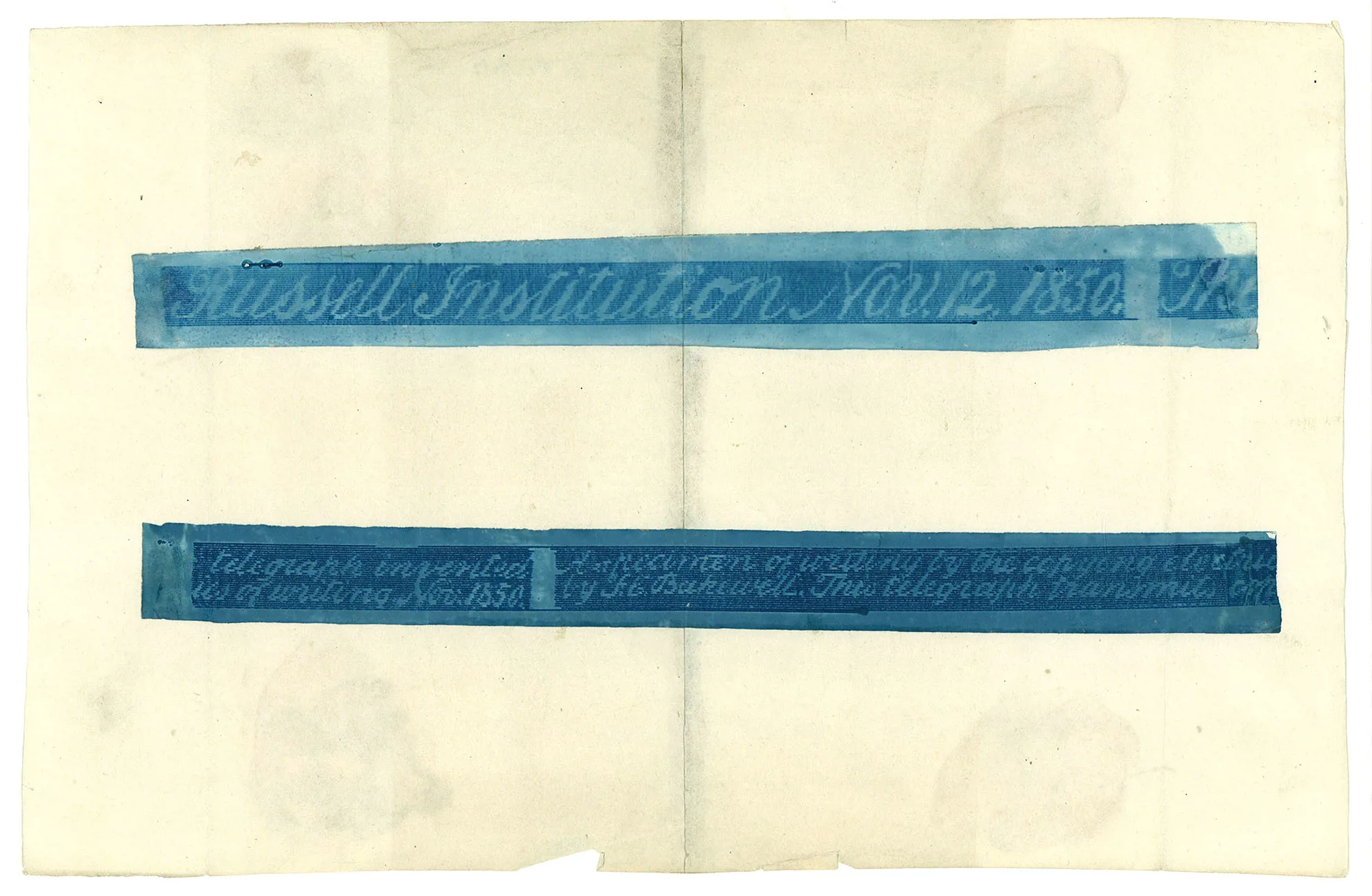

Their exhibition catalogue entry proclaimed proudly "This printing telegraph effects all the purposes of telegraphic communication by a single wire only; printing in Roman ... letters, recording in duplicate with the rapidity of a compositor... It is worked by galvanic or magnetic electricity, and controlled by hydraulic or atmospheric regulators." On display were specimens of the "printing executed at 200 miles distance". One of these is now in the Archives of the Institution of Engineering and Technology, illustrated below.

Mounted strips of paper with a message printed by the electric printing telegraph. Top strip reads:
'Russell Institution Nov. 12 1850. The'
The second strip reads:
'telegraph invented. A specimen of writing by the copying electric/ ies of writing. Nov. 1850. by F C Bakewell. This telegraph transmits cop'
Translation- 'A specimen of writing by the copying electric telegraph invented / by F C Bakewell. This telegraph transmits copies of writing Nov. 1850.'
