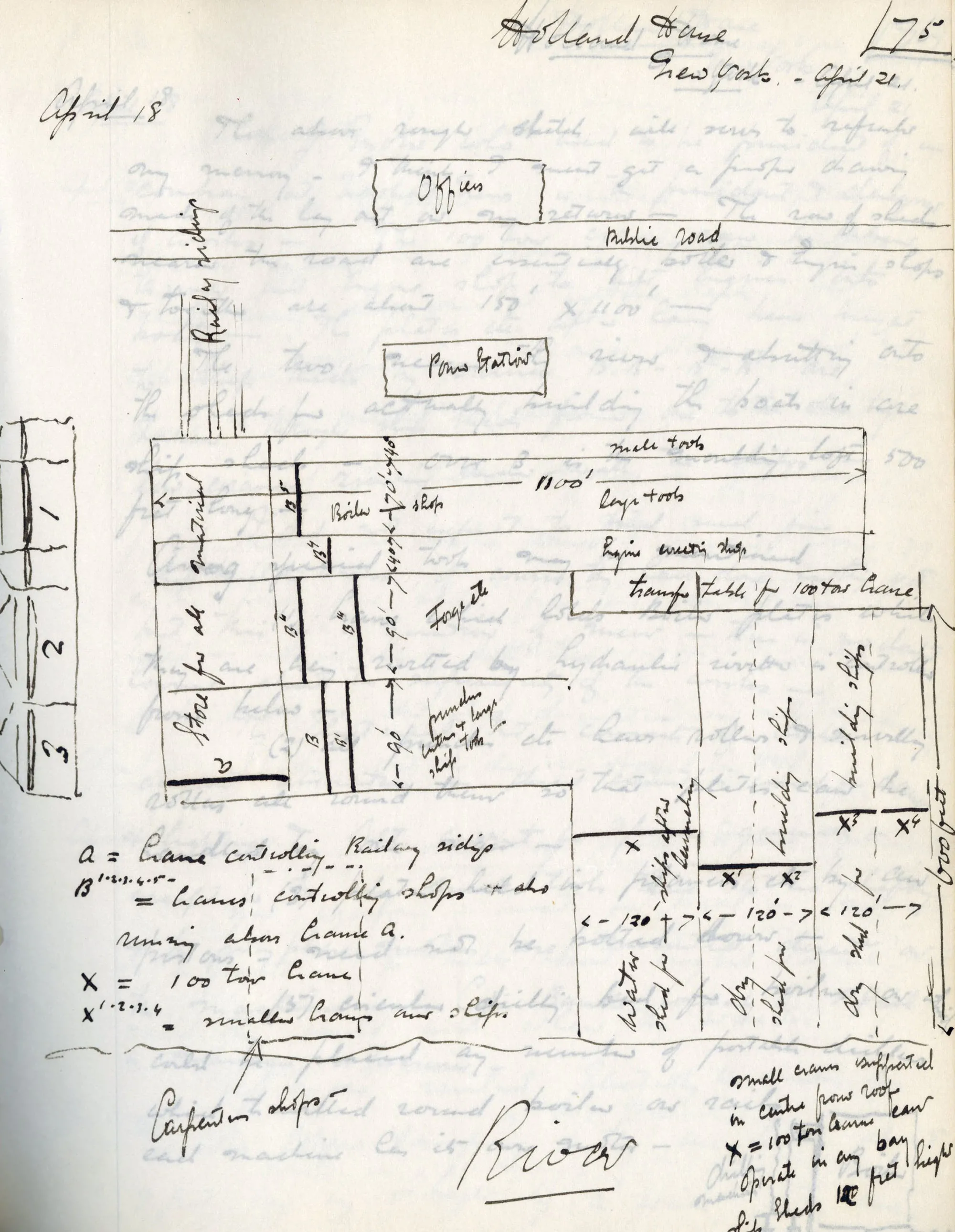

The diagram shown is of the New York Shipbuilding Company's works which Merz visited during his trip to the USA and Canada in March and April 1901. In a letter to his partner, William McLellan, he said that they were “perhaps the most interesting works I have seen while over here—quite modern …”  He commented that he was impressed by many special tools developed for specific tasks, and concluded that “I did not expect to find such fine shipbuilding works … There is no doubt however about the superiority of the works.”
