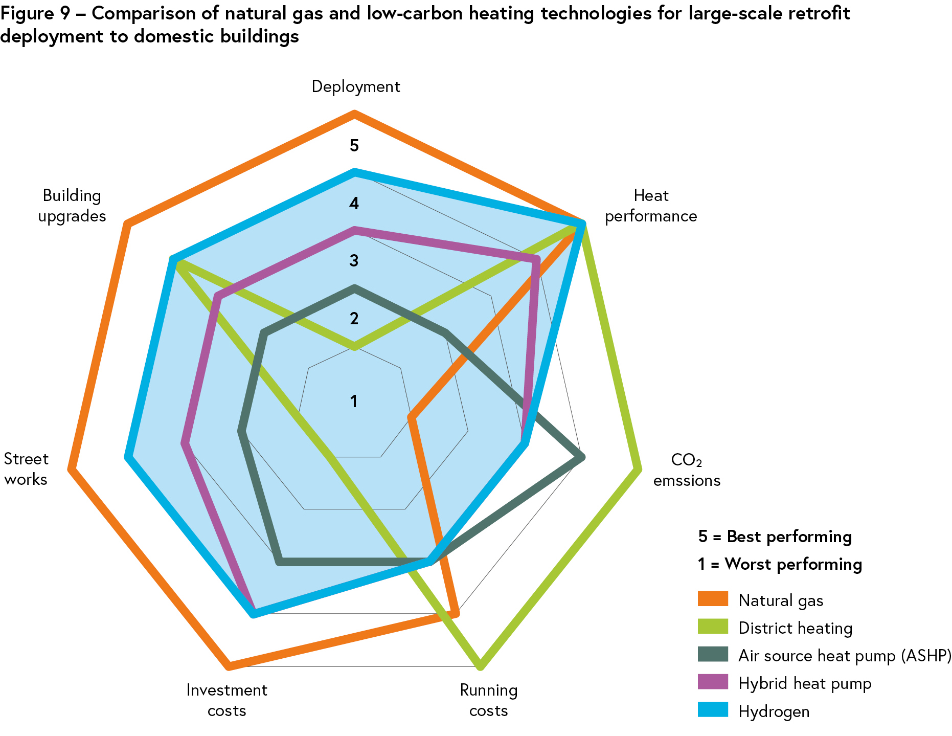

  • Hydrogen compares well with other low-carbon heat technologies
    The diagram compares the primary heating technologies suitable for large-scale retrofit deployment against several criteria. While the comparison is subjective and generalised, it is not meant to indicate that one form of heat technology is “better” than another but to illustrate the different features and to highlight the potential benefits of hydrogen. A full explanation can be found in the report.
