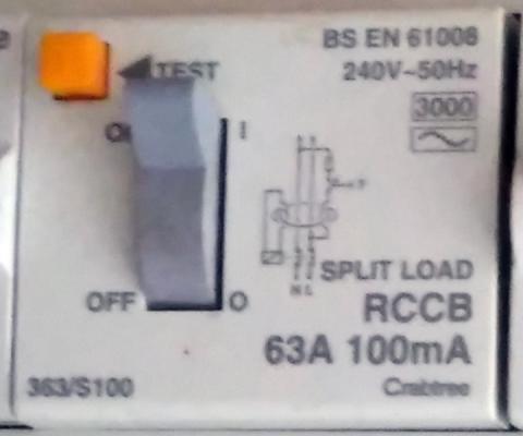

Please see below. There is a main switch, then two lighting circuits, then the RCD.

The 100mA R.C.D. suggests an original TT supply. What it is now is anyone's guess. The black earth wire ages the installation a bit, probably back to the 1950s/1960s.
Ah yes, but it's split load innit?
Wozthatthen?

So there we have it : TN-C-S, but not PME (or even PNB).
The earthing conductors look untidy, one is too short and less than professionally installed. D.I.Y?
