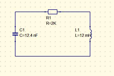

I am tryingto perform what I thinkshould be a relatively simple task, i.e. calculate the discharge time of a capictor in a series LCR circuit. I can happily find formula's and calculate a CR discharge rate but am unable to find the right stuff for LCR, and being fair it was 20 years ago I last used this sort of maths, and theory, in anger, and those brain cells are long gone.
example cct
The basics:-
I have a long cable (100km) , with known LCR (and G, although I'm ignoring this) characteristics. The cable has been operating at 1000V AC and the supply (and load) is removed.
I then assume the caple remains charged at 1000V as a capacitor C.
With the known cable inductance L and a known resistor connected across the cable R to discharge it, how do I calculate the discharge curve allowing for the chokeing effect.
I appreciate the cable has been simplified to an L C element and this is even massively simplified from the true LCRG version it should be but my rough calcs show we will not have a massive hold up time anyway so the cable model can be simplified.
Either a formula or link to the correct website would be useful, please remember my brain cells are fuzzzy so the resultant answers need to be farly clear. And please don't just give an answer to the values in the example as I have to model this for other cables.

Arthur, This is practical. Unfortunately it is not possible to earth by way of earth stick, switch etc as the system has to provide the means for controlled automatic dissipation of the charge. The application is a submarine cable between an oil / gas platform and the subsea well, which must be physically discharged when the power unit goes off line. This allows for diver and ROV safety and also electricians on the platform working on the cable joins before it goes subsea. It is accepted that the cable would naturally discharge but the forced 'controlled' discharge is required in a known given time frame, which is what I need to be able to calculate. The cable is supplied with single phase (actually a transformer output so L-L voltage applies with no earth reference). Thanks for the time looking so far though. Geof

Have you tried modelling this in Pspice? That is certainly the way I would approach it (I could probably just remember enough to do the maths but wouldn't trust myself to get it right!). There is a free version available which should be powerful enough, if you google student pspice you'll find it. It probably has a transmission line model in which might help.

I think you need to define the problem as a differential equation and solve it. If I remember correctly from long ago, Laplace transforms are handy tools to simplify this.
